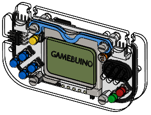

- Check the screen holder is in place to prevent the screen from moving (see picture on the right). Note : the screen holder has now been replaced by a grey rubber pad stuck on the upper part of the screen so the pressure is more even and it limits PCB bending.
