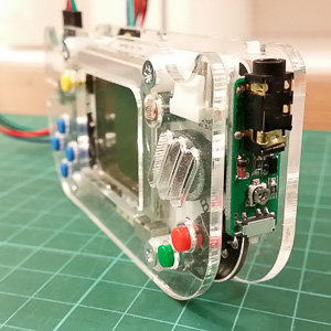

I connected an ADXL345 accelerometer module (very straightforward as it's an I2C module) and adapted one of the examples of the Gamebuino for it to take acceleration into account. It only took a few minutes... quite promising. What would you do with an accelerometer ?

...say, is that black thing attached to the right on your gamebuino an earphone jack?

rodot Fri Jan 09, 2015 7:05 pm
...it might be...

That's really cool. Do you think you'll be adding modules like this to the store? It would be great to finally have a headphone jack especially. Was that one hard to attach?
rodot Fri Jan 09, 2015 8:36 pm
The headphone module is soldered on the edge of the Gamebuino PCB, as it's not a conventional way to do I'm checking that it wont break. But I think that I will order some along with the next batch of Gamebuino to add them to the shop. I'll make a video to show how to solder it.
