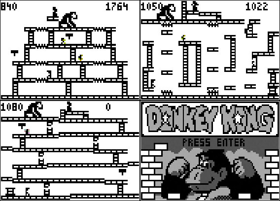

The graphics capabilities of the Gamebuino appear similar to the TI-83/83+ (although slightly higher res @ 96x64). ( Ex: https://www.youtube.com/watch?v=_-LAkTP4G2E ) There are lots of YouTube videos on TI-83 games. TI-83 games are written in asm or basic. Would it be possible to copy or clone some games from the TI-83 library without much hassle? (Recoding from scratch might even be something I'm willing to do.)
There are a lot of Nintendo game clones for the TI-83 and I imagine some of the more popular franchises would hold some inspiration and interest for the masses.

As the Ti-83+ has a Z80 processor and the Gamebuino an AVR processor they work very differently, so the easy answer is no, you wouldn't be able to just simply make something so that you can run ti-83+ games on it.
Then again, another issue is, as you pointed out, the screen is a different size.
The easier thing would be to just inspire yourself of those ideas and write your own version of those from scratch.
Another issue with just emulating the ti-83+ is the waaaaaay larger RAM you have available, 24K and some free areas all across the OS, the screen drivers are way different, the games might use more keys etc.
The upside is that the gamebuino has a more powerful processor, though. But then again, if it had to emulate the Z80 I'm not too sure if that would help any.
