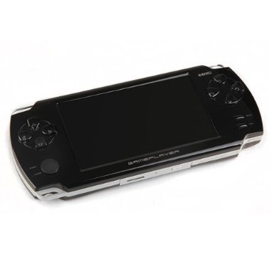

The analog Stick is a D-pad shaped as a Analog Stick (mechanicals contacts), but it's work very well for all games that I have tested, I think it is better than a Push Buttons D-pad. I get this in a "Junk?" (não sei como se diz "sucata" em ingles...rsrs) of ZX-8321 (one of this chinese Emulator's console very similar to JXD A1000).
(is the same Analog Stick that I used, and don't need any modify to work with gamebuino)
