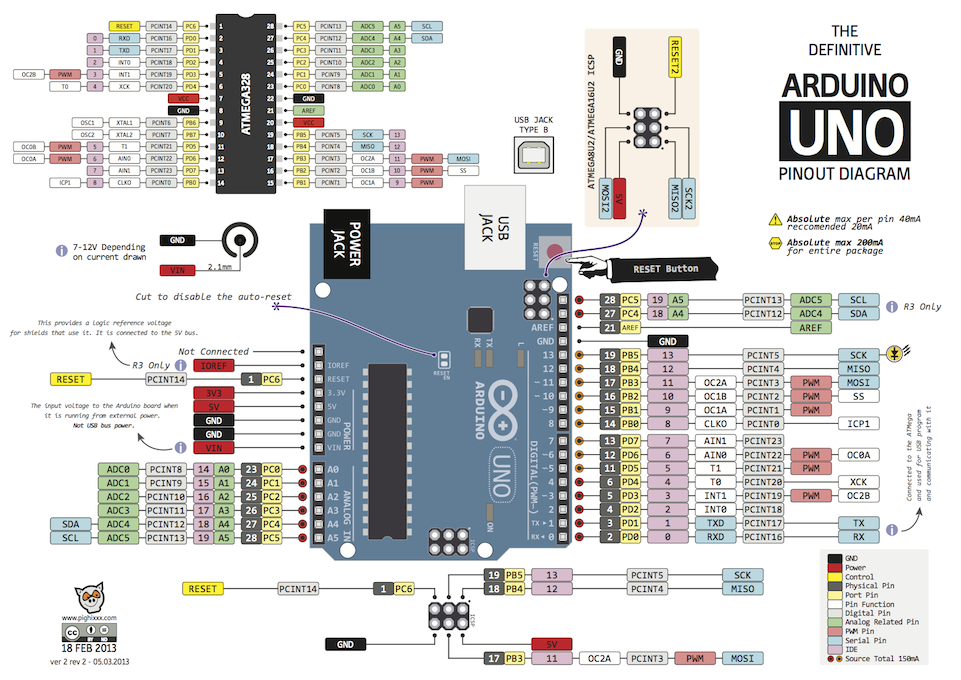

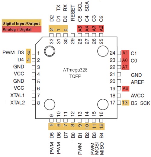

And here is the ATMega328P (the flat TQFP version that is on the Gamebuino) to Arduino pinout
The yellow marked numbers are the digital pins of Arduino. The red pins are the so-called "Analog" pins of Arduino. Next to those numbers, are marked the actual Port and Pin names of the ATMega328P. So for example yellow "5" on Arduino is actually D5 = Port D, pin 5 on the Atmega. It is also pin number 9 in the TQFP packaged ATMega328P. A6 and A7 are special pins that are for input only. They are used as ambinet level light monitoring and battery level monitoring on the Gamebuino. You can connect the battery level to constant high, if you do not want to build a battery charging circuit yet.

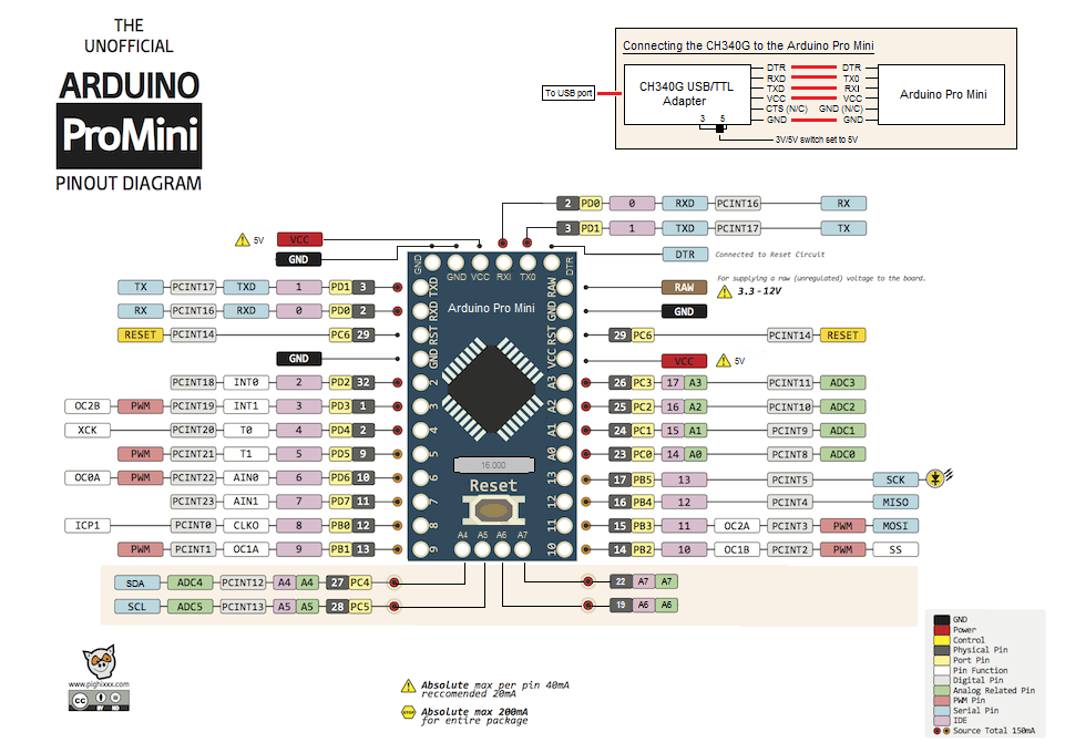

Myndale Wed Oct 14, 2015 11:04 am
I find these pinout diagrams invaluable, you can find them online for all the major ATMega chips and Arduino boards:
