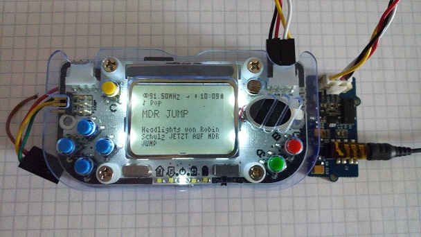

Made a little fm tuner app for the rda5708m module with support for rds. (From seeedstudio, I think it's ok to mention the manufacturer here as it's referenced at gamebuino.com too)
Screenshot:
Src/hex: https://github.com/scmar/Radio?files=1
Left/right is search for station,
A: stop search
B: toggle mute
Up/down: volume
Screenshot:
A: stop search
B: toggle mute
Up/down: volume

What is that cable/extension on the left side?
Sutchig Fri Oct 16, 2015 9:27 am
the cable on the left is a 9DOF-Sensor board. (accel, magnet and gyro) It fits between the backcover and pcb :)
sadly this module and the fm-tuner doesn't work together, althought they have different i2c-addresses. if they are both plugged in, only the sensorboard is found. :(
