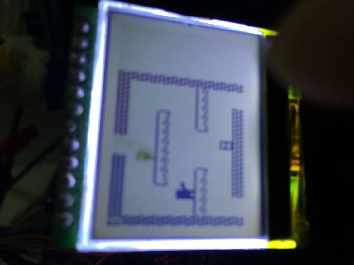

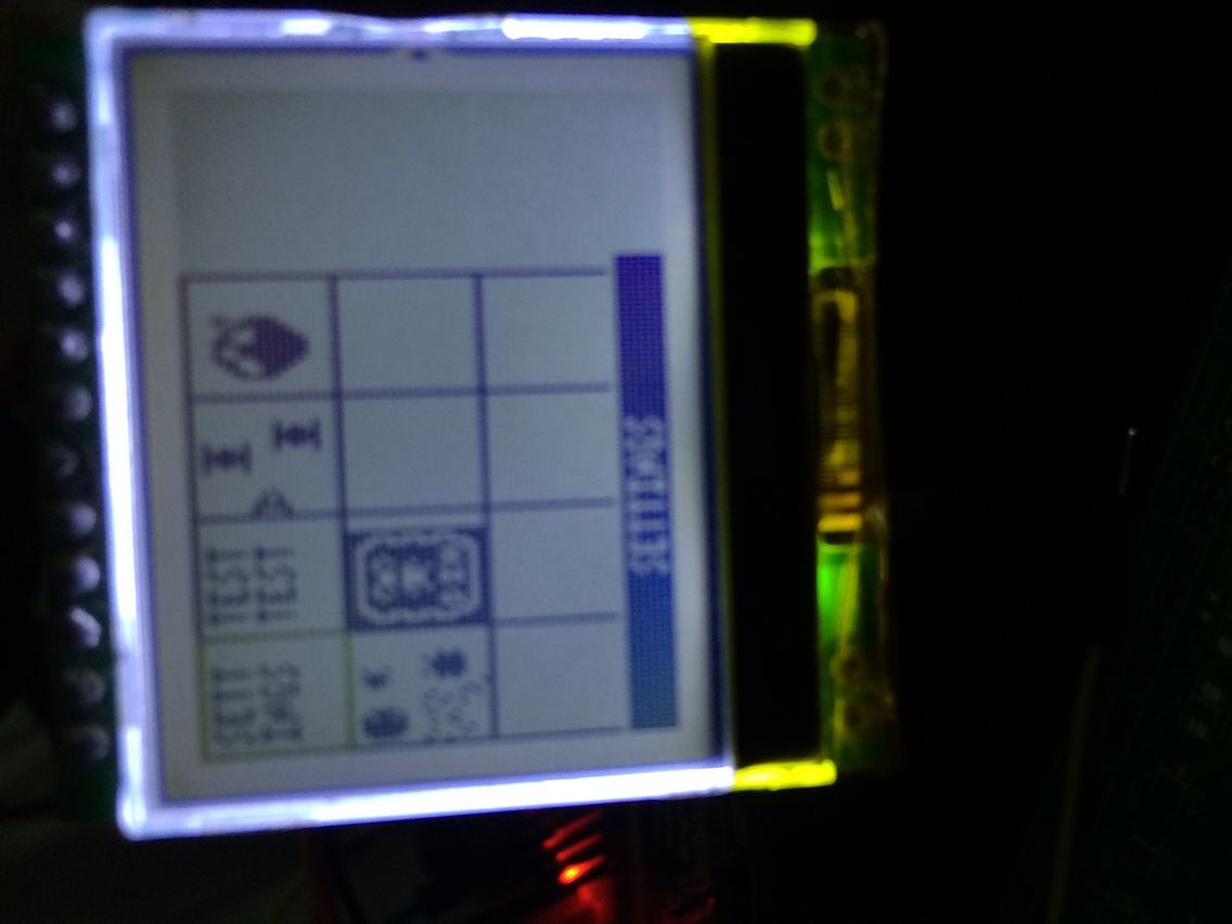

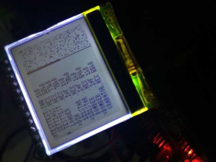

Now show you my results.
Game Test
Loader Test
Old loader Test
