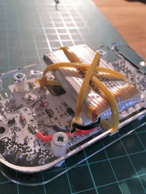

dogwoodfire Thu Mar 17, 2016 6:56 pm
Haha, wish I'd seen your comment before I ordered them! They were too thick, but I was able to improvise:
Please excuse my shoddy soldering, first time getting out the soldering iron since high school.
