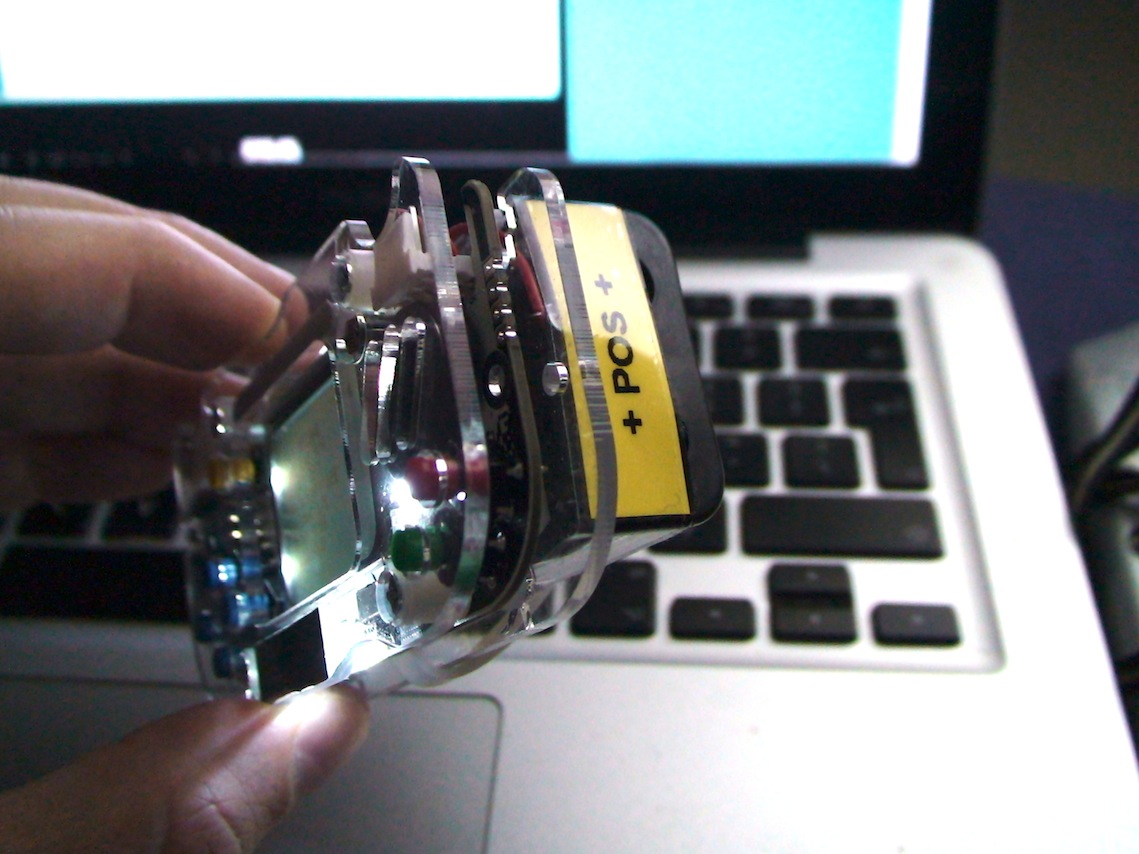

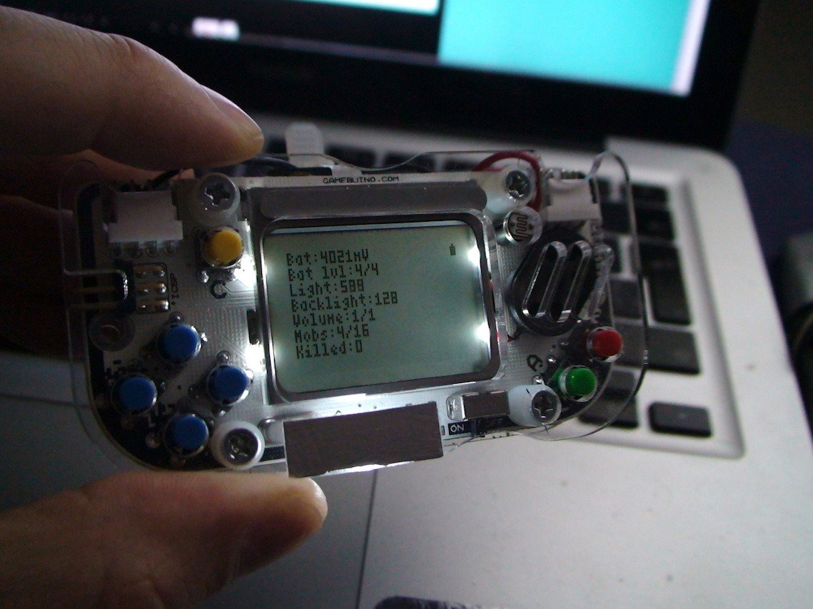

Dear Sutchig, I just realised that you may have trouble charging your Gamebuino after removing the USB socket!, so I attach some pictures of my solution (modified 18650 battery housing so they run parallel).. it's hardly lost any voltage after days of use! Whilst this may seem a bit cumbersome, it does work well for my purposes.

many thanks for your advice and the photos. I still hope to get that fixed by soldering the connector in the right position ;) Or to charge it via I2C or something. But your way is a good option if nothing works. :)

Uau, those pictures are funky, while not a fan of the more usual batteries, I have to say it looks interesting.
