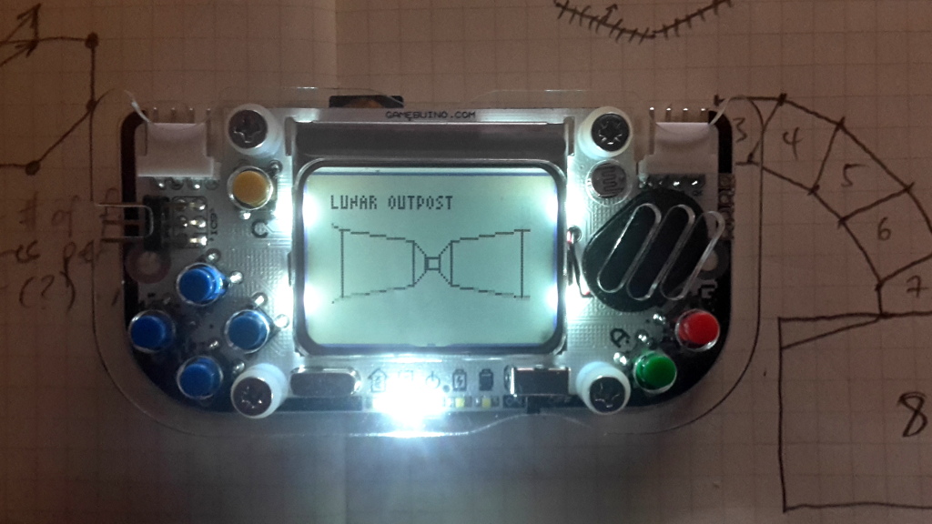

Hey, I've just recently stumbled across the Gamebuino and ordered it right away. And I have to say I'm stunned by the idea, the look and feel, and the huge amount of games. What an awesome project! Thanks, Rodot!
I've seen the 3D engine demo and was very excited about it and decided to try and build a mini Descent-like clone. And it's already in a state that can be tested:
Source: https://nhcham.org/descent.ino
HEX: https://nhcham.org/descent.ino.hex
Rotate with direction keys, press A to go forward, press B to strafe.
I've implemented the demo as a portal rendering engine (https://en.wikipedia.org/wiki/Portal_rendering). The level consists of convex 2D segments which are connected via shared edges. Segments may have different floor and ceiling heights. Currently there are 9 segments in the game.
There's a couple of things still left to do:
Oh, and there's only ~100 bytes of RAM left when running the program, and it won't survive going back to the menu and being restarted, probably because RAM is tight. I'm still trying to figure that one out - I've certainly learned a lot about RAM usage!

rodot Mon Dec 12, 2016 10:32 am
Looks promising ! Descent 3 was actually the first game I bought (quite a while ago), so I'm really looking forward to the final version :)
Could you link to any tutorial or documentation about this kind of rendering, for those willing to understand what's going on behind the scene (including myself) ?

nhcham Mon Dec 12, 2016 10:40 am
@rodot: Thanks, I've uploaded the image and added a link with a portal rendering primer! I'm planning to write a detailed post about how this works in the next couple of weeks.
