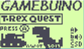

My first game for Gamebuino,
made with my son who likes T-Rex :) whitin an afternoon,
i am not a pro coder so i made what i could, thank for your feedback
Features are :
- Score counter
- Health bar
- Fire bar
- add a hitbox on the TREX and the TANK
- Sometimes a random chily appears instead of an apple (chance : 1/10) the chily allow the TREX to fire with a mega ray blaster all over the screen.
- i used Split H function on the "fire" sprite, instead of a different sprite of fire splited on the left
- intro and logo at the starting page
- Level 1 / Level 2 / Level x according to the score, 100 = next level
- The tanks speedup at each level
- Add a game over screen at the end, with the score
[update : 07/02/2017 : v1.1] : add the possibility to get back to the title screen (by pressing 'C'),
[update : 03/03/2017 : v1.2] : add logo and tile : INF file,
.hex and .elf files attached + ino file.

Sorunome Sat Jan 21, 2017 9:05 pm
Hello there, welcome to the gamebuino forums!
Looking at the screenshot the game is looking quite nice, however, while you did provide the source it'd require us to compile it.....would you mind to upload the .hex file? You'll need to put it into a zip archive to be able to add it as an attachment
EDIT: Looking briefly at the code you use "void setup();" to call the function after you die, however just "setup();" is sufficiant. On that point, i don't know how good it is to call gb.begin(); multiple times, what you do with that. You might want to split the title screen and that "GO TREX" thing into a new function and call that one instead.

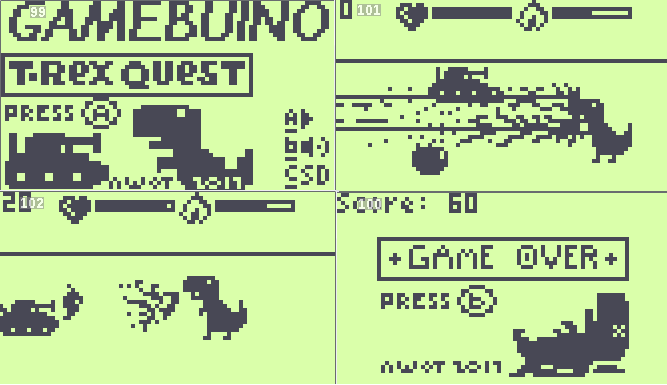

Awot Fri Feb 03, 2017 3:48 pm
Yes, I still work on it, i have some ideas to improve it :
Update done :
- add a hitbox on the TREX and the TANK, on the plan of their foot (and not on the sprite, it was not "realistic" )
- add : intro and logo at the starting page :
[img]intrologo.png[/img]
Todo :
- Add : Level 1 / Level 2 / Level x according to the score. (e.g : score > 500 => level 2, and level 2 has more tanks )
- More than 1 tank at every level (=> how to do ? : array of tank ? )
- Add a game over screen at the end, with the score (how to do it ? can't find how to pause game easily )
I would appreciate if you have any ideas, or sample of code to help me with my todo list,
I would like to post a new hex version when i'll finish the Todo list.

Awot Sun Feb 05, 2017 1:34 pm
Thanks guys
I managed to do the Game over and the Level screen.
I just can't make multiple tanks yet, but the tanks double speed at each level.
I updated the first post with the last version.
I consider this as the v1.0 version. :)
