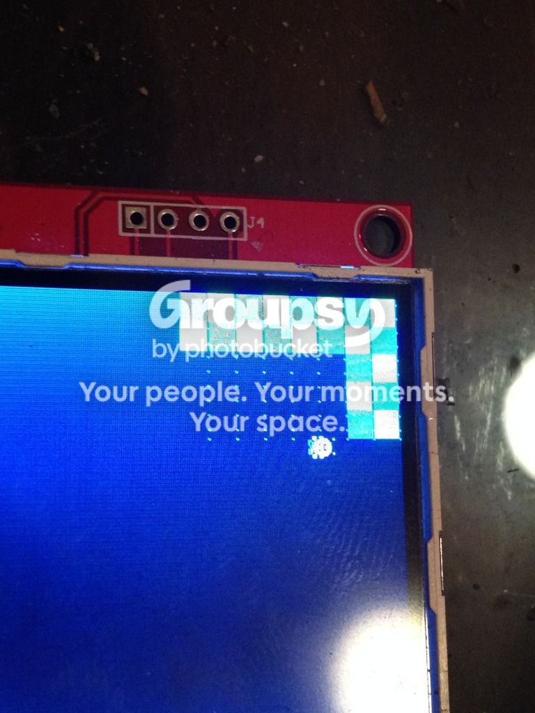

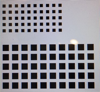

I stuck at adding the tilemap function. I can add as many bitmaps as I want by calling them at once but when I try to use the tilemap function below all I get is a few pixels from each bitmap. a 15 x 7 tile map puts out a column. Im hoping someone can help me fix this...

heres mine
Code: Select all
//adafruit_gfx
   void drawBitmap1(int16_t x, int16_t y, const uint8_t *bitmap, int16_t w, int16_t h, uint16_t color);
   void drawBitmap2(int16_t x, int16_t y, const uint8_t *bitmap, int16_t w, int16_t h, uint16_t color, uint16_t bg);
   void drawBitmap3(int16_t x, int16_t y, uint8_t *bitmap, int16_t w, int16_t h, uint16_t color);
   void drawBitmap4(int16_t x, int16_t y, uint8_t *bitmap, int16_t w, int16_t h, uint16_t color, uint16_t bg);
   void drawXBitmap(int16_t x, int16_t y, const uint8_t *bitmap, int16_t w, int16_t h, uint16_t color);
   //GAMEBUINO----SUMMONER123------for tilemap--Duhjoker
   void drawBitmap(int8_t x, int8_t y, int8_t w, int8_t h, const uint8_t *bitmap, uint8_t dx, uint8_t dy, uint8_t dw, uint8_t dh, uint16_t color);
   boolean getBitmapPixel(const uint8_t* bitmap, uint8_t x, uint8_t y);
   //draw from SD  mouguino updated by Duhjoker
   //Draw bitmap from SD at position x0, y0
   //void drawBitmapFromSdA(byte x, byte y, char *bitmap, uint16_t color);
   //void drawBitmapFromSdB(byte x, byte y, char *bitmap, uint8_t dx, uint8_t dy, uint8_t dw, uint8_t dh, uint16_t color);
   //int drawBitmapFromSd(byte x0, byte y0, char *bitmap, uint16_t color);
   //void updateSlide();
   void drawTilemap(int x, int y, const uint8_t *tilemap, const uint8_t **spritesheet, uint16_t color);
   void drawTilemap(int x, int y, const uint8_t *tilemap, const uint8_t **spritesheet, uint8_t dx, uint8_t dy, uint8_t dw, uint8_t dh, uint16_t color);
[/code}

Duhjoker Tue Jan 31, 2017 8:53 am
Ok here's what's going on when I call the tilemap function. If I give the starting coordinates to 0 and 0 I get two thirds of a 6 X 6 tilemap, I also have three drawBitMap functions going in random places that I set that appear fully. If I give the tilemap start coordinates to say.....
110 and 170
The tilemap doesn't move but it appears smaller.

Edit:::
I tested multiple stacked bitmaps in seperate colors today. I used my Dune games paul atreades. He sure was small but it worked. Still cant figure out the tile map. I hope some one can help with that soon.
Duhjoker Fri Feb 03, 2017 8:18 am
Can pretty please get some help figuring out why I can only display partial tilemaps using the tilemap feature. Im also having a drawbitmap at int x and int_y glitch as well that might be part of the tilemap problem.
I started a sketch with my 6x6 tilemap green and yellow then added some my paul atreades bitmaps and did all the walk stuff, then changed the player_x and player_x defines at the top 160 X 110 and barely moved from the original 50 and 50.
naed Fri Feb 03, 2017 5:00 pm
The hardest part of this is that your using bespoke hardware and libraries
My guess
If the screen resolution is larger then moving it over by 50 pixels is only going to move it a small distance, because the pixels are much smaller and as far as I'm aware your library is still only using pixels to place the sprites
Don't know if I explained that so you understand but it's the best I can explain it
It's also difficult to help because any suggestions/help we give will only be able to be tested by yourself... It's pretty much a guessing game without the hardware
**edit**
If your pixel sizes are different you can see from the above pic how moving from one corner to the other would give you different sizes/distances

maybe its a typo or something im missing from the sketch. idk but I need someone to be serious for a minute PLEASE
EDIT::
ok so I fixed the player_x, player_y problem and now he shows up at the coordinates entered. kind of.....I had to comment out the walk bits. I tried several ways to include them properly, I know its punctuation but I cant figure out. I tried adding more "}" and less but I cant figure out to include them right. For example......

ok so with the comments above removed I get nothing and back to 32 and 32. but now I cant move him.
ok but I did the the button problem fixed as well. I had forgot to add the update and begin the latter being first to the begin. but wait that didn't work. I actually had to add buttons.begin and buttons.update to the sketches void setup. but now when I press a button the bitmap changes to reflect that direction.
