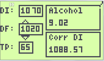

When i brew my beer at home, i am always looking for 2 informations :
- the final Alcohol content = (initial density-final density)/7.6
- the corrected initial density according to the temperature of the brew = ((0,1963596*temperature)+(0,002661056*temperature*temperature))-5,431719) + initial density
So i made this little tool on Gamebuino, with an ergonomic (i think) data imput menu.
Interface:
- Left part : imputs of DI, DF, TP (DI: initial density; DF : final density; TP : temperature of the brew in °C)
- Right part : results : Alcohol content and Corrected initial density.
- A Button : change imput line : DI, DF, TP
- Up/down : increase or decrease the selected value
- Left / right : only for DI or DF : these numbers are big : eg: 1020 => modif : 10 then modif : 20

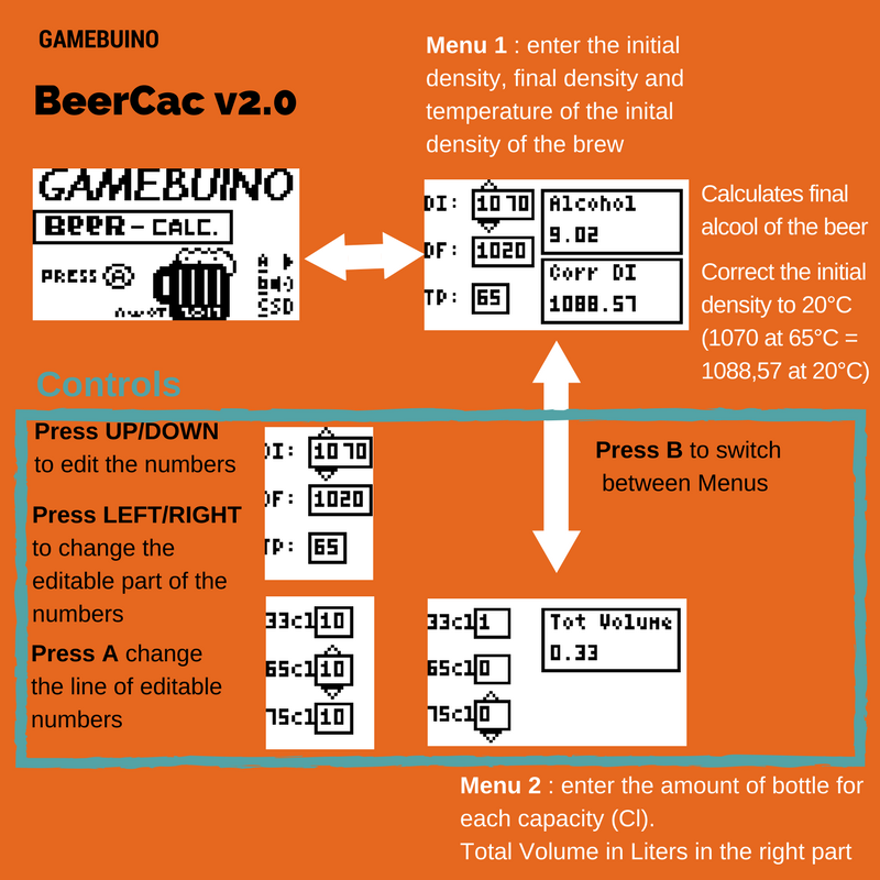

i have done this poster (i don't know how to call it) for this program, to help understand functionalities.
it may not be perfect, but the goal is to have all functionalities of a Gamebuino program or game in a single simple view.
it would be nice to have a template for all Gamebuino games..
