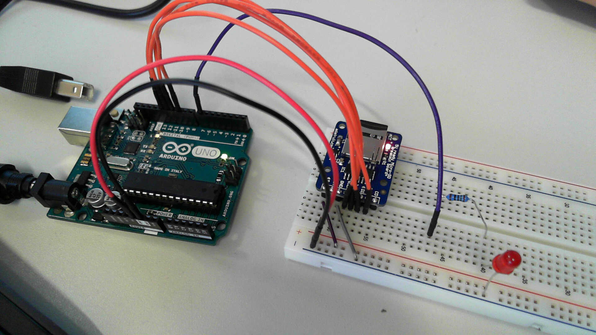

I also double checked the wiring with the schematics of GB and everything seems fine. Here is the wiring:
ARDUINO -> Adafruit microSD breakout
5V -> 5V
GND -> GND
PIN 10 -> CS
PIN 11 -> DI
PIN 12 -> DO
PIN 13 -> CLK
At least I flashed the sketch that is responsible for loading the target sketch to the arduino. Which looks like the following:
After the "Load Blink" is written to the serial monitor the sketch is stucked and the red LED on the Adafruit microSD flashes infinitely.
Here is an image of the wiring.
Do you guys have an idea what the problem might be? Is there anything else I have to consider when formatting the SD card? I would be grateful for any help!
Sorunome Thu Feb 09, 2017 3:33 pm Re: Using bootloader to load sketches from SD with arduino u
IIRC you need to somehow specially format a larger SD card to make it recognizable by the bootloader, easiest would be to just grab a small micro sd card and format it FAT16

flea Thu Feb 09, 2017 3:58 pm Re: Using bootloader to load sketches from SD with arduino u
Sorunome wrote:IIRC you need to somehow specially format a larger SD card to make it recognizable by the bootloader, easiest would be to just grab a small micro sd card and format it FAT16
EDIT: More on that here: http://gamebuino.com/wiki/index.php?tit ... ng#SD_card
Thank you. I'll check that out. Is there a way to format the SD card to make it recognizable? That would be awesome, since a SD with less than 2GB would take some days to arrive.

Myndale Mon May 01, 2017 3:34 am Re: Using bootloader to load sketches from SD with arduino u
A couple of other things to keep in mind....although you're using a Uno you'll need to make sure your target board is set to Gamebuino. The SD bootloader is 4K so your Uno needs to be set with different flags.
Also I notice you're using a hardware burner. You'll need it to burn the bootloader but make sure you're not also using it to upload the blink sketch; avrdude typically does a full chip erase each time it uploads.
