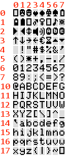

I would like to print each alphabet letters with a Serial.print(..
in the wiki, the gb.display.print page it is said : Serial.print("\7") gives an empty battery symbol
and the ASCII table :
So i suppose we could read the alphabet by incrementing a "Letter" variable like this :
Serial.print("\" & Letter) <= Something like these but i don't know how to do here ?
(And "Letter" would be from 101 to 132, and avoiding all number after 7 => 101, 102, 103, 104, 105, 106, 107, 110, 111... )
So my question : how to use a variable "Letter" in a : Serial.print("\...") to print ASCII table ??
thanks

Awot Thu Feb 16, 2017 11:13 am
i will answer my question, here is what i found :
Using : gb.display.drawChar(x, y, char, size);
the "char" is the number of the Decimal character in the ASCII printable characters table
so 65=A ... -> 90=Z
and not the HEX char in the tables below :
and not the OCT char int the table in my fist post
so HEX 41 = DEC 65 = OCT 101 = "A" ect..
all this can be found here : http://www.ascii-code.com/
also in order to have real uppercase character we need to use
and
e.g. this program print a big uppercase Z character :
