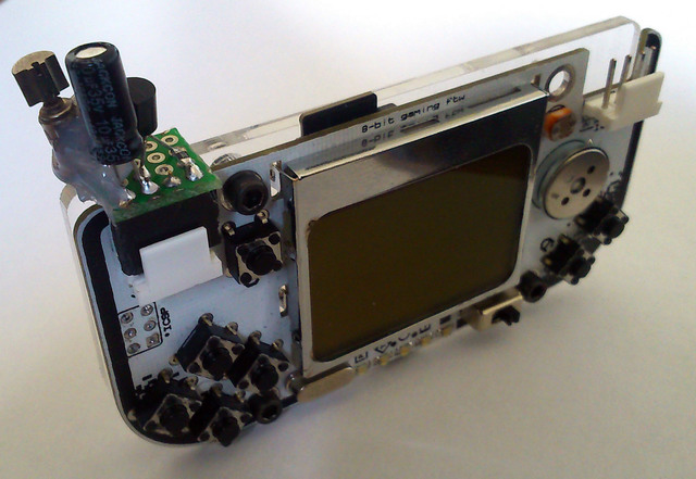

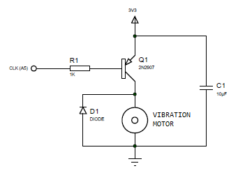

To actually FEEL explosions, add a vibration motor (do NOT search for "vibrator") which cost about $1:
Put all these components on a small piece of PCB:
It looks ugly, but works pretty well:
Do you think this is a must-have feature?
adekto Sun Mar 23, 2014 1:49 pm
lol just call it a rumble pack (thats what other console's did XD)
just an idea if u can get 2 moters one with a slightly more weight and on oposite ends of the device it would give a biger kick (thats how curent consoles do it)
and dont google vibrator!!

Drakker Sat Apr 19, 2014 11:30 pm
rodot wrote:Do you think this is a must-have feature?
Frankly, no. Every time I play a new game on a console which support it, I go straight to the options and turn vibration off. It is the most damnable annoyance in games today.
With that said, if there is demand for it, then yes, do it.
Skyrunner65 Sun Apr 20, 2014 12:58 am
It's not needed, but more of a "oh, its kinda cool" thing.
Also, I really don't see how that simulates explosions. Seriously, here's what happens:
*Controller rumbles*
My hands are tingling!
It's like spiderman up in there.

DFX2KX Mon Apr 21, 2014 7:20 pm
Skyrunner65 wrote:It's not needed, but more of a "oh, its kinda cool" thing.
Vibration is a handy feature to have, but it can be vary easy to overdo (Play Elysian Tail with vibration turned on, then get the combo counter up some, you will have numb hands, guaranteed!) Hrm, If I could figure out how to open a STEP file, I could figure out a way to work around the part sticking up in the air...
erico Mon Apr 21, 2014 7:25 pm
It is horrible to open that STEP file, but you can do it with FREECAD.
The vibration could be used on a racer game, when bumping on other cars, or while skidmarking/power sliding around. In general I´m not too found of it, but I see there are some nice occasions it could be well used.
