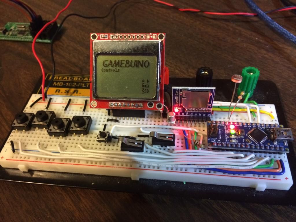

So I just wired it up like the schematics and boom! I'm playing games!!!
Here's my steps:
Mapped Arduino Nano to Atmega pins in schematic
Mapped " ISP to Jytech USBasp programmer I had
Wire up SD card - used R1=22 and R2=47 ohm V-divider from 5V input (3.4V), Photoresistor, Speaker (from old phone)- also used 2N222a bjt (didn't have a hi-freq one - seems to work fine), buttons, LCD, Pot (behind LCD)
Followed instructions from wiki for bootloader
Followed instruction from Arduino website for burning from Arduino IDE - Not sure if I did this right - still haven't loaded a game from SD yet!
Loaded a sketch (basic) and moved curser around to map buttons to Nano correctly - I left a little extra wire on each for this
Played a little Crabator!
P.s. I created image and text files of the mappings but know that I read somewhere on here that Rodot doesn't want to upload his schematics yet, so unless I get his blessing I will hold off for now!

Nice work treflip, your schematics are really nice. I love the colored wires. Which program did you use?
I did the same thing with my nano.
Only thing that doesnt work on my nano was the bootloader.
I can read the sd card, load games with the loader sketch, but i cant invoke it when the C button is held on startup.
I was discussing it in this thread:
viewtopic.php?f=7&t=526
Anyway...hope you make the bootloader work on your nano

treflip Tue Jul 01, 2014 1:31 pm
Hey Albertinjo!
Thanks! I use MSpaint. It does most of what I want, most of the time!
I haven't proven I can write/read to/from SD card yet (just probed it w/ Logic Analyzer a little) but I have the same problem with loading from SD... I'm in the process of recompiling the gamebuino_boot.c file in the gamebuino_boot folder but get this error:
Not sure where it is cuz line 0 isn't found anywhere and ( is a very common character!
