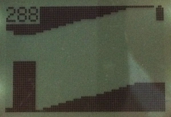

This is a simple clone of the famous Helicopter Game for Gamebuino.
Rubbish photo, because I work on Mac/Linux and can't take an emulator screenshot

ripper121 Mon Jul 21, 2014 10:39 am
The code looks really nice organized :)
You can upload Pictures with UPLOAD ATTACHMENT and then you can insert it.
annyfm Mon Jul 21, 2014 11:28 am
Thanks for pointing that out to me - I didn't notice originally. I've edited the OP to include the screenshot as an attachment.
