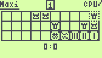

So, I'm presenting Senet on the Gamebuino:

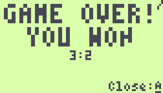

After winning the match:

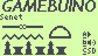

I finally got a better title screen:

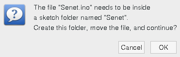

I'm sorry if that's a stupid question, but how do I compile your source? I cloned the repo but arduino wants a scetchfile in it's own directory and there's no Makefile.
rodot Mon Jul 28, 2014 4:34 pm
I guess you simply open senet.ino in the Arduino IDE and compile it? Of course you have to set up the Gamebuino library first.
94k Mon Jul 28, 2014 4:41 pm
That's exactly the problem, the arduino IDE complains about the missing sketch directory. I could move it but I'm pretty sure it would break dependencies.
Attachments: 2014-07-28-184034_371x118_scrot.png
rodot Mon Jul 28, 2014 5:27 pm
Oh, that's not a problem, rename the containing folder to "Senet" ;)
94k Mon Jul 28, 2014 5:31 pm
I did, but there's other files beside it, and I'm pretty sure that Senet.ino uses them, so putting Senet.ino in a folder alone most likely won't work either.
rodot Mon Jul 28, 2014 5:35 pm
I didn't tell you to put senet.ino in a subfolder, but to rename the folder containing all the files to "Senet". Does that work then?
