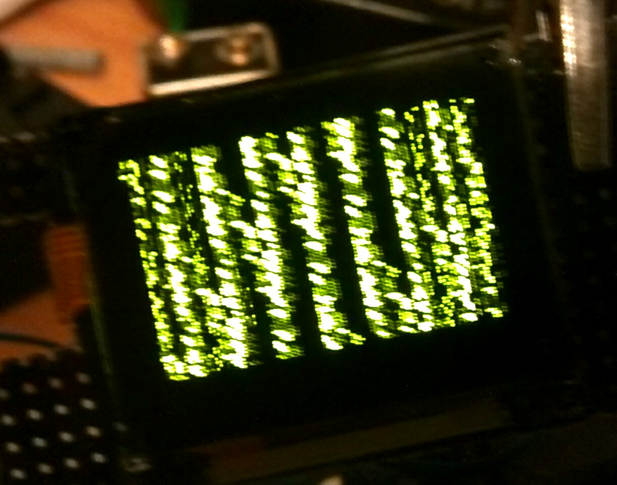

DLBB Tue Sep 06, 2016 5:30 am First light
Ok. There's something like a picture on oled.
I connected the hardware SPI pins of the 328p to the oled.
This means I'm on the right track.
Way to go...
Way to go...
Attachments: IMG_20160906_072959.jpg
