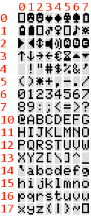

Special characters can also be printed (cf. character map on the right).
Serial.print("\25Accept")gives the A button symbol followed by "Accept" -
Serial.print("\23\24")gives a speaker symbol with sound waves -
Serial.print("\7")gives an empty battery symbol
